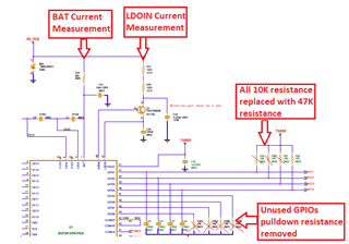

I was unable to reply previous  tag as it was somehow blocked.
Please see the below part of schematics and new changes made and sleep current measurement done.
Sleep mode current measurement at different test conditions.xlsx
Different test cases was made to verify sleep mode current values  written in.the  BQ79616-Q1 datasheet.

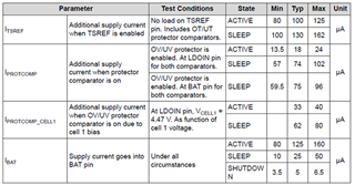

Test  Case  4
Sleep mode UV/OV/OT/UT Protector  Enabled     with Protector ON 146 micro Amp current increased in the LDOIN pin and 70 micro Amp currrent increased in BAT pin
Fault Mask Enabled   Micro Amp
Tsref
CVDD  LDO  and RTC  Removed 0
LDO IN current   560 micro Amp
BAT current   103 micro Amp
Total    663 micro Amp
in the above test case no 4 when protector enabled then 146 micro amps  current increased in the  LDOIN pin and 70 micro amps current increased at BAT pin.
and this current increase is not given in the datasheet. please justify this current increased.
