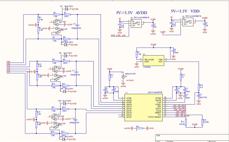

The customer uses TPS54331 and TPS7A2033PDBVR, please help to review the schematic.

Please ask customers to use an 8.2uH inductor. For compensation network parameters, please refer to webench recommended results. There are no obvious problems in other parts. Thanks.

Currently, the customer use a smaller inductor. Therefore, the ripple value of its inductor current will be larger. In this case, the loss of the inductor will be bigger and it will be more likely to saturate. Generally we choose Kind between 0.1~0.3. Thanks.
