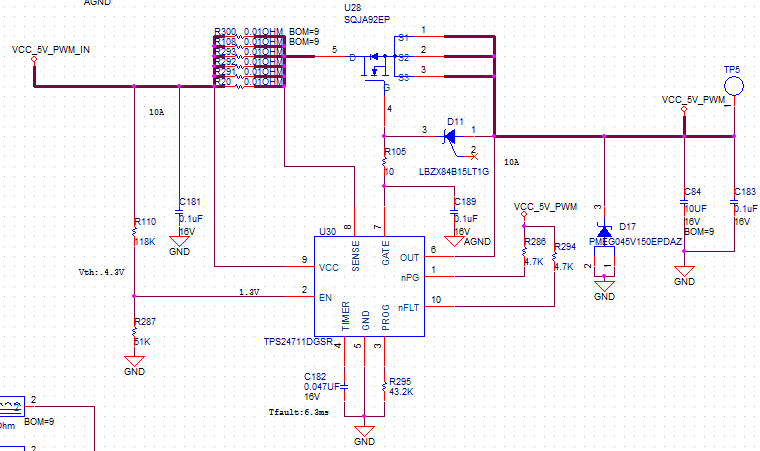

Hi Team,
This is FAE Jayden, my customer O-net is using TPS24711 in their new design. But recently they found a strange phenomenon in their design.

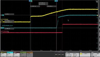

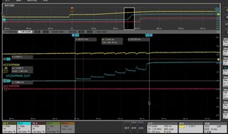

Customer measured that the waveform at the OUT pin of the TPS24711 will appear steps, rising step by step, as shown in the blue waveform. What may be the cause of this phenomenon?
Yellow curve: Vin Blue curve: Vout
