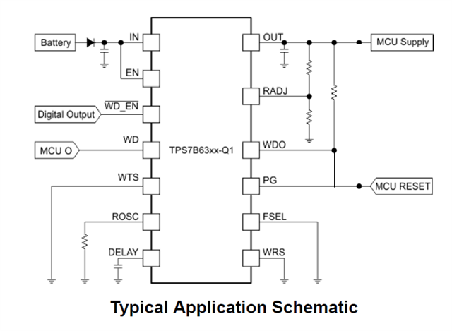

Hello team,
Greeting for the day.
I want to know if it is feasible to connect WDO and PG pin together for same pull up resistor, the structure is shown as below.
When there is a problem with the WD signal output from the MCU to the LDO, or when there is a problem with the voltage output (OUT) of the LDO, the MCU is supposed to RESET.
    Thank you for your question.
    After reviewing your question, I have determined that connecting the PG pin to the WDO pin should not cause an issue for:
    "When there is a problem with the WD signal output from the MCU to the LDO, or when there is a problem with the voltage output (OUT) of the LDO, the MCU is supposed to RESET"
    The only concern I have is that when attempting to debug, it will be difficult to tell whether the WD is in a fault, or the output is having a problem.
    Please let me know if you have any additional questions or concerns.
