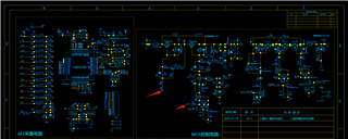

Dears,
Battery 13 series, CUV threshold is set to 2.7V, when triggered to CUV, the battery voltage returns to the set value, discharge will damage the DSG MOSFT;
It dose not work when the set value are changed from 2.9V to 3.1V.
Dears,
Hello User,
Were there any waveforms for the DSG gate-source turn-off? Which FET is being damaged? I see there are two DSG FETs. Do remember, DSG turns-off voltage will depend on the LD pin.
