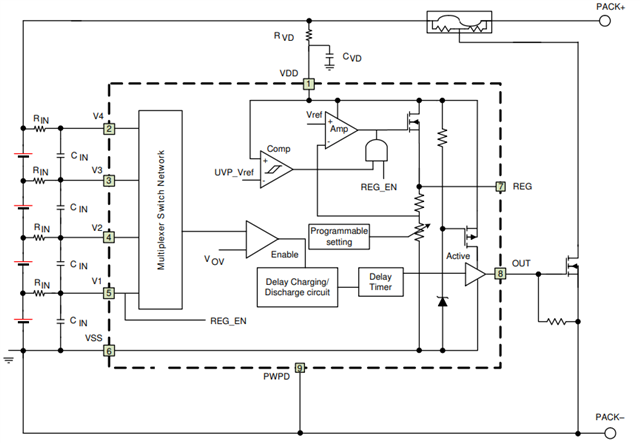

Could you help to share the efficiency of 3.3V REG pin output?
If it was applied in 4S pack. The efficiency should be (3.3V / 4.2V * 4) = 19.6% or (3.3V / Vref ) = % ? If so, what is the Vref value? Thanks!

Hi Kailun,
The REG output is going to be driven by VDD, so the efficiency will be around 20% in the case you've calculated.
