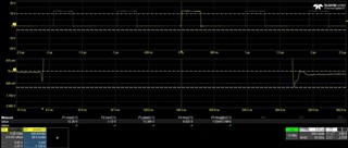

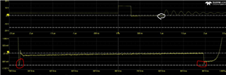

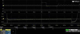

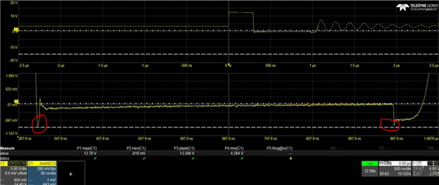

Since the undershoot in the switching waveform of the TPS62175 is close to 1 V, I also measured it with EVM, but the result was the same.
The results were the same. I tested with no load and 350mA load.

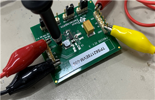

As shown in the attachment, the GND line is as short as possible when measuring, but is it really that much?
Can you try to measure it there too?
