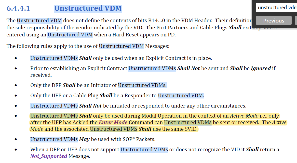

step:
1.Configure the interrupt mask register 0x14 (bit 56/57/58/59)
2.Configure user AM configure register 0x4a(bit 0/32/48/40)
result:
Enter mode fail UVDM not support
questtion:
how to configure UVDM
step:
result:
questtion:
Hi ,
Can you please share the config file and USB-PD logs.
Unstructured messages can be sent only after the UFP has Ack’ed the Enter Mode Command. Can we check if there is Enter_Mode for 0x12D1.
Thanks ,
Shubha
