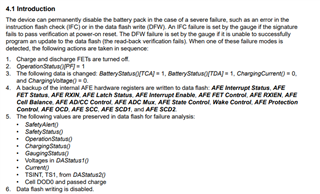

When the PF occurs, how could we wake up the Gauge IC ?
Hi Fabio,
The 0x0029 command will reset the PF data flash. Please see the image below taken from the BQ28z620 TRM.
Jonny.
