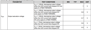

Hi Jaared,
Thank you for the reply. May I also know the minimum voltage of Vout?
Shunsuke Yamamoto
Hi Shunsuke,
Please refer the spec in below table and you can find it in EC table on Chapter 7.5 in datasheet.
BR, Jared
