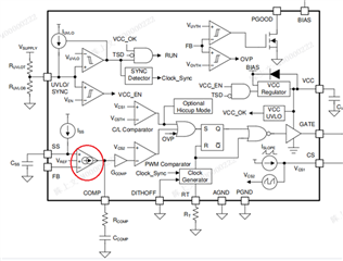

Customer was trying to design an isolated flyback with LM5156.
There were several questions as below, could you please help address them?
1.  How to understand the input and output relationship for the below OTA? When FB is connected to GND, what is the behavior for the OTA output? High impedance?

    1. This is related to the softstart behavior.
    During softstart, the SS voltage is compared to the FB voltage.
    After Vss reaches the level of Vref, the softstart is finished.
    From this point onward, Vref is compared to the FB voltage and SS voltage becomes irrelevant until the next startup.
