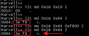

My customer is trying to write TPS546D24 Toff_delay register (0x64h) from 0xf83e to 0x f800, but after write 0xf800 into 0x64h then read 0x64h, it still 0xf83e inside 0x64h as below.
I had check TPS546D24 0x64h all bits are read/write, value inside 0x10 register is 0x00, and my customer is write register during power conversion not enable condition.
May I know is there have other items I didn't mention will cause 0x64h can not wirte?
