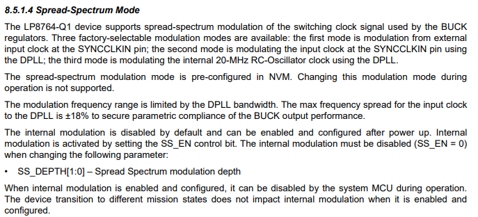

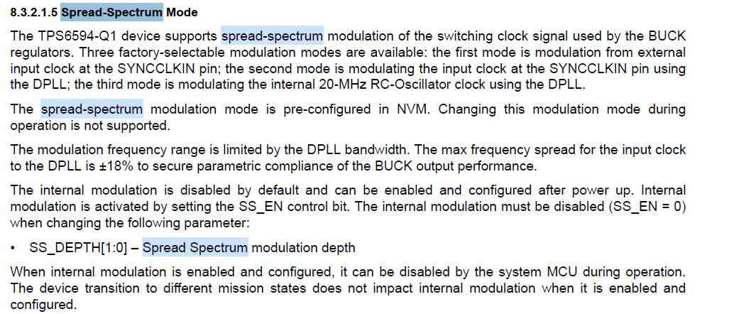

I'm curious about how to enable the Spread Spectrum function for TPS6594-Q1 and LP8764-Q1.

Hello MyoungBong,
These are settings done in the programming (NVM) of the device and are not available to change during runtime.
For the TPS6594 Datasheet:
From the LP8764 Datasheet:
