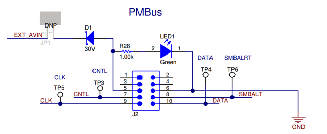

I think that if customer want to configure the device during debugging, he only need to connect the two pins PMB_DATA and PMB_CLK to the external host, a connector is not necessary, right? Any suggestion? Thanks in advance,

They will need at least 3 connections. CLK, DAT, and GND. Adding ALERT can also be useful.
