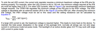

I am currently working with a board I designed around the TPS61196PWPT. My aim is to get 250 mA per string and I am having trouble achieving this regardless of the resistor values I use the driver is topping out at around 190-200mA. My Rset resistor (R11) below is 19.6k and I am currently using a 37.4K resistor for my IFBV resistor (R10). By the math and graph provided by the data sheet I believed I would have enough head room for the 250 mA out but plan to try another resistor value for R10 closer to the 38K ideal value for 600mV of head room.
What would be the ideal resistors to use in order to achieve 250mA out? All component values on this board were directly chosen the same as the TPS61196-EVM.
