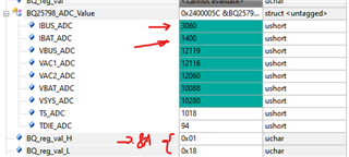

The BQ25798 charger IC charging current is not as expected. The battery pack is 3s LiFePO4 battery pack.
I set the charge current to 2.8A and when it shows that the charge current only 1.4A but the Vbus current went up to 3A.
Is this ADC error or something wrong?

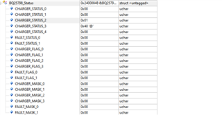

    There is zero fault flags reported:
  • Hi Nan,
    The ADC must be wrong.  Unless you have disabled IINDPM limit in REG0x14, IINDPM is 2850mA and you are measuring 3060mA, which should have charger in IINDPM.  But there is no IINDPM status. Are you measuring the input current with a meter?  Is it really 3A?

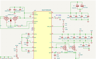

    Is this on an EVM or your own board? If your own board, did you follow the recommend layout, esp the PMID and SYS 0.1uFcapacitors?
    Jeff
  • I do have the IIDPM enabled:
    This is my own board, the PMID and SYS caps are showing below:
    You think there are more 0.1uF caps needed?
  • Hi Jeff,
    There was a mistake on the current reading, the ADC value is 1mA /bit but not 10mA/bit, I was misled by the configuration where the bit step is 10mA.
    Sorry about that.
    So I measured the Ibus current on my board, it matched the ADC value red from register, thus, the ADC readings and capacitors have no problems.

  • Hi Nan,
    When battery is removed, charge goes to trickle charge ~=100mA into BAT.  Can you download the status and fault registers in REG0x1B through 0x27 as well?  They will report what is happening.
    Jeff
  • The Reg  0x1B to 0x27 is on the previous image I posted above. The Charger_Status_0 is 0x1B and 0x27 is on the fault_flag_1.
    they are all zero
