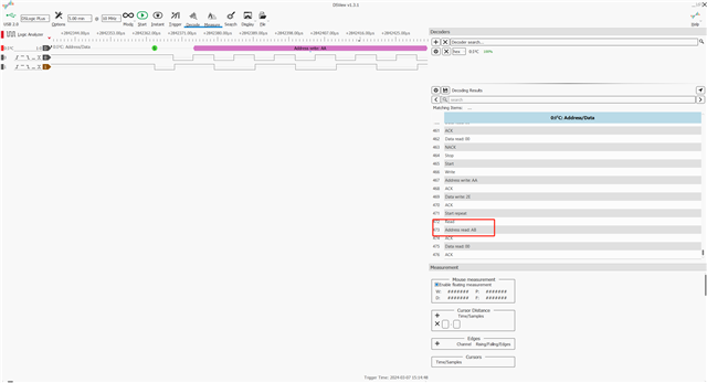

Part of our product's bq35100 can't switch from Full Access mode to UNSEALED mode. Can you provide some example code for mode switch?
the bq35100 is always in Full Access mode (0,1 Full Access)
Although we can enter UNSEALED mode using EV2400+BQ Studio, the large amount of data on the I2C bus makes it hard to analysis.
Even worse, some address like 0xAB cannot find relevant definitions on datasheet.
Our current mode switch code is as follows. Are there any obvious issues with these?

I also referred to the slua801.pdf, but couldn't find the code related to mode switching.
So we still hope to provide us with an example code.
