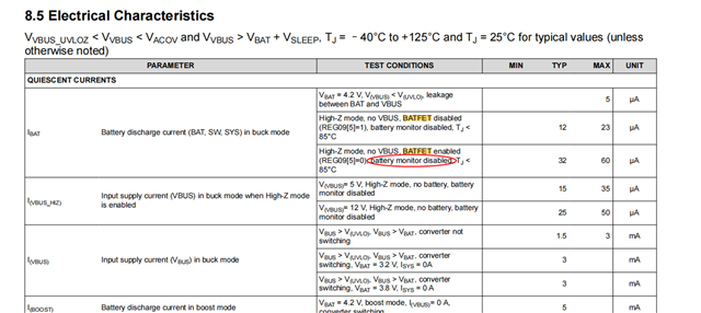

Hi
I have a query need your help.
I can't find the disable battery monitor function in the datasheet, so I don't know how to enter high-Z mode.
Waiting for your reply.
Star
  • Hi Star,
    The battery monitor refers to the ADC function. There is a section describing this function called "Section 9.2.8 Battery Monitor" on page 28 of the datasheet. The ADC feature is disabled by default. The relevant register is REG02 bits 7 and 6.
    HIZ mode is enabled/disabled in REG00 bit 7.
