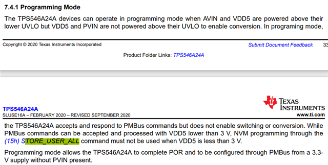

Could you pls suggestion how to store the configuration into NVM? Do I need to power off the PVIN, and reduce VDD5, and put the device in programing mode? Pls clarify.

No.
STORE_USER_ALL can be executed while the part is in operating mode or programming mode.
