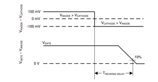

In datasheet, T_Reverse delay is defined Typ.0.45us/Max0.75us. Can customer estimate this time on their use case?

Hi Miyaoka,
T_Reverse delay is shown as a graph in the datasheet. It is the time of (some propagation delay + FET to turn OFF) after it detects -100mV drop across the FET. Since the FET is discharging here, it depends on the gate capacitance. Only thing to note here is that the discharge current is very high(~2.37A), changing the gate capacitance will not change the time by much.
Hence, more or less the time should be same with change in systems.
