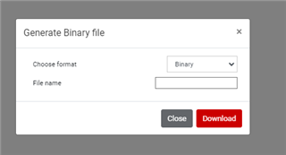

  • Thank you for answering.
    TPS25750 Not using EVM. This is a uniquely designed board.
    Please tell me how to write a board designed by your company to FLASH.

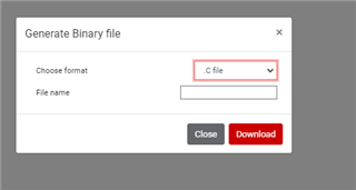

    Binary files to be written to FLASH can be created using "Generate Full Flash Binary" on the GUI.
    Can the generated file be used as is on I2C-Host (REX-USB61mk)?
  • Hi Kensuke,
    Please look at section 4.2 in the TPS25750 TRM. If you are doing and EEPROM-less design and loading the App Config firmware to the PD controller from an I2C host, you will need to follow the procedure described there. You will need to generate the low region binary as a .C file for this procedure.
    If you are using an I2C EEPROM, you can use the "Generate Full Flash Binary" option to generate a file in the Binary format, and use an I2C flash programmer (or your I2C host) to program the flash directly.
