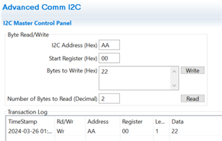

  • Hello Steve,
    I am glad to hear that you managed to get the I2C communication operating properly. For the FETs, do you have the FET_EN bit set?
    Jonny.
  • So if I use MacSubCmd to read Manufacturing Status at Register 0x0057 value is 0x0000 so apparently the FET's are not enabled.
    {If I set calibration mode then bit15 of this register goes high so I am pretty sure that this is the correct register & data].
    Next question then is how do I set FET_EN bits [and presumably I also need to enable Gauging and Data Collection - same place ??????]
    In the TRM [SLUUC09-DEC 2022] Section 15.3.6 there is a "Manufacturing Status" Register in Data Flash - default set to 0x0000 so I think I need to change this.
    The address of this register is however not evident ...... in the DF table there is a value for "Mfg Status Init" at address 0x43C0 but I can find no exact match for "MANUFACTURER STATUS"..... Changing the value at 0x43C0 does nothing as far as I can tell [ and this is an weird address being a long way from the address range of most of the other settings].
    I also tried using a MACsubCommand to enable and disable FET's [e.g. at Register 0x0022]  but this results in a bus error on the i2C bus.
    Other sub Commands work just fine using same software function so I have no idea yet about this. Will try to debug.
    So still no idea = how do I change FET_EN value and get this part to do something useful ?!?!?
    Have to say that the documentatiuon for this part is terrible. Descriptions are cryptic and there are many errors and ommisions.
    Please help me with more than a one line answer.
  • Hello Steve,
    To set the FET_EN bit you can write the 0x22 to the start register 0x00 and the I2C address 0xAA. I have tried this with my EVM and bqStudio to confirm. Please see the image below.
    Jonny.
