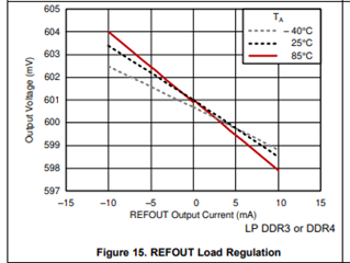

1) Does Output Voltage(mV) in Datasheet P10, "Figure 15. REFOUT Load Regulation" mean VO(3 pin)?
2) If yes, could you provide a graph of "REFOUT Output Current" vs "REFOUT Output Voltage" for DDR4?

Hi Yuta,
1) In Figure 15 the output voltage is referring to the voltage on the REFOUT pin. VO voltage follows REFOUT during operation which is why the load regulation of the REFOUT pin is of importance.
2) Figure 15 is REFOUT voltage. Load Regulation implies that the output under the current loading condition is also being monitored for voltage changes.
