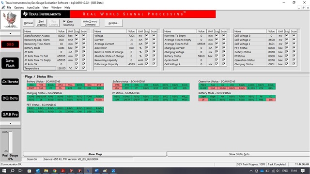

The problem is we were not getting the voltage at the battery pack output. The FET connected at the output is not turning ON. I even provided the external voltage to the Pack+ and Pack-. After providing voltage the device got detected in EVSW and communication has been initiated but there is no voltage at the output of the pack.
After that how to proceed further to configure the gas guaging ic to get required output. I'm sharing my current SBS window.
The gauge's protector detected an Over Temperature in Discharge and Cell Under Voltage condition. Please make sure that both are corrected (or change the protection thresholds accordingly, see 2.1.1 and 2.1.4 in https://www.ti.com/lit/ug/sluua93b/sluua93b.pdf).

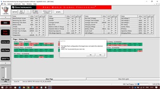

Thankyou. So I need to update dataflash CUV Threshold, Recovery values and Over Temperature Dsg, OT Dsg Recovery right. But when I'm switching to DataFlash window it pops up an error which reads as "The DataFlash configuration file does not match the detected target! Select Yes to proceed at your own risk" (Image attached below).

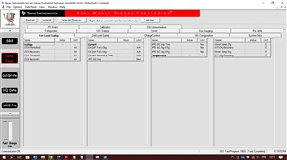

When I move forward by clicking Yes, the DataFlash window appears. (Image attached below).

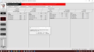

Further I import the .gg file with the updated values of thresholds and recovery the values get updated in DataFlash window. But when I click the "Write All" button it pops up the error which reads as " The last Read All had errors. EVSW is unable to preserve data integrity. The write operation will be aborted! An automatic "Read all" will be initiated! " shown in image below.
When I press ok it pops up communication error which reads " Error reading data flash Subclass BQ2050 config, Code = 772."

Please confirm which gauge you are using. The headline says bq20z65-R1, bq34z950 and your last posting says bq20z655-R1.
EVSW for bq20z65-R1 should work with bq20z655-R1. Your screenshots show that you selected the bq34z950. Please select the bq20z65 instead.
