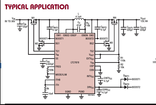

Hi Expert,
May I use LM5177 M1 & M4 mosfet as pic to do the Efuse function ?
Or you have any other better suggestion in here to build up Efuse function on LM5177 ?
Eddie
Hi Stefan and Team,
Because my customer want to use LM5177 or LM5171 to build the BBU power system.
And they will hot swap to connect will datacenter power , so input will see the rush power when connect and disconnect moment.
they want to have like Efuse or hot swap function , do we have any other suggestion to avoid ? or recommend application circuit ?
Eddie
Hi Eddie,
i still have no good understanding of the targeted application.
On which side the hot swap should happen? Input or output / Battery or application side.
Should this be an Efuse only or an SMPS with disconnect feature?
(Perhaps an Block Diagram would help to understand.)
Stefan
