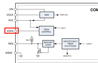

How much current can vdda provide?
I want to use vdda power supply for OP-AMP, about 1~5mA.
Hello Yan,
Do not suggest loading the VDDA other that recommendations shown in the datasheet.
The VDDA regulator has a 20ohm internal resistance and a UVLO circuit, don't suggest loading the VDDA with anything exceeding ~10mA.
if you need a low current bias supply, suggest using the VCC.
Hope this helps.
David.
