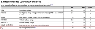

    thank you for using the E2E forum.
    The LM5176 is specified down to -40 Degree.

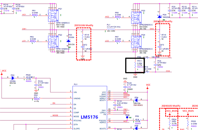

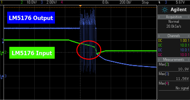

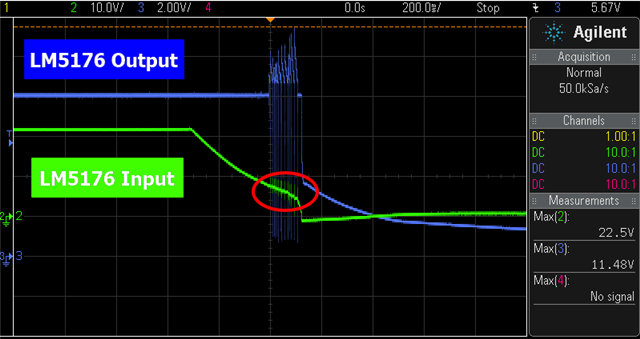

    It's the voltage difference caused by the voltage step on the oscilloscope and the use of a diode on the Vin path, as attachment. I try to adjust voltage step 10V to 5V, the voltage is not difference to much. Our input voltage range is 5~36V, during the test, we use the 12V and 24V adaptor for testing.
    During the test, 12V and 24V were used for testing.

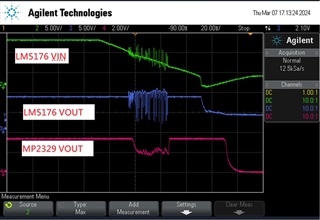

    The problem of voltage jitter only happen at low temperatures(-35D) when the adapter(AC side) is removed.
    I tried to do the some testing, it's also happen with other DUT and I found the jitter happen that the voltage mod change buck to boost when remove the adaptor out as show the below.
    12V Adaptor
    24V Adaptor

  • Hi Hung,
    just used the quickstart calculator ( can be found on the product page)
     LM5176 Design Calculator
    and entered the design data base on the info in the schematic
    Note: assumed a DC BIAS of the output cap of 50%
    With VIn if 7V the design only has 31 Degree phase margin / with 5V only 13 Degree.
    So the compensation loop might get unstable.
    You might try the design with
    374 Ohm / 33nF / 15nF for PR13 / C963 / PC24
    Please also use the calculator to check your design.
    Note: UVLO is also set to 2.7V which is very low for a design which should work up on 7V.
    Note: Slope compensation value is set higher then recommended. Use the recommended value or the next lower.
     Stefan
  • Hi Sir,
    We did a lot of testing to look for possible issue. We found the  issue maybe from the PR11(0.004R) as follow the figure black box. We don't see this issue when we use the different vendor, so I want to know if the resistance of current feedback (PR11=0.004R) is maybe cause this issue? Thanks.
  • Hi Hung,
    the current signal of the current sense resistor connected to CS/CSG is an essential part of the control loop for the LM5176.
    So if this signal is not properly delivered and measured, the controller will not be able to work properly.
     Stefan
