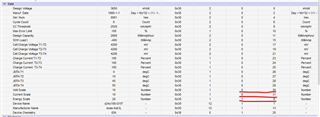

BQ34Z100-R2: BQStudio beta 34Z100R2 block data offset does not match with 34Z100R2 Technical Reference Manual Data Flash Memory Summary Table
Part Number: BQ34Z100-R2
Other Parts Discussed in Thread: BQ34Z100, BQSTUDIO
Which offset is correct ?
Note :  BQStudio does not contain "BQ34Z100_R2 100_2_01". So i used BQStduio Beta .
In BQStudio Beta BQ34z100 100_2_01
Volt Scale Offset = 0*32+30 = 30
Current Scale Offset = 0*32 + 31 = 31
Energy Scale Offset = 1*32 + 0 = 32

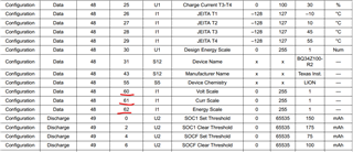

In BQ34z100 Techincal Reference Manual
Volt Scale Offset = 60
Current Scale Offset = 61
Energy Scale Offset = 62
