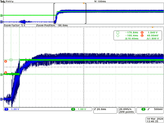

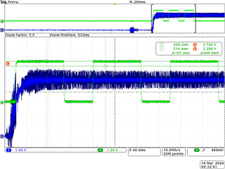

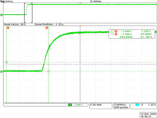

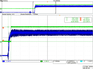

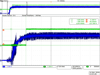

I have a question about the circuit that supplies power to the AM6422 using TPS6521901. The power is only outputted three times before it stops.
Blue: VSYS(5V)
Green: Buck2(3.3V)
It appears that there is a fault and it is going through two retries before shutting down. In the output voltage waveform, the outputs of Buck3 (1.2V) and LDO2 (0.85V) seem to be abnormal.

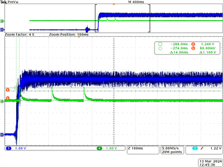

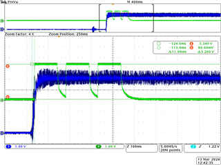

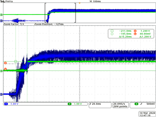

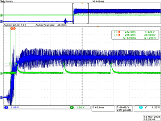

For the 1.2V output:
Blue: VSYS(5V)
Green: Buck3(1.2V)
The output voltage drops faster compared to the 3.3V output.

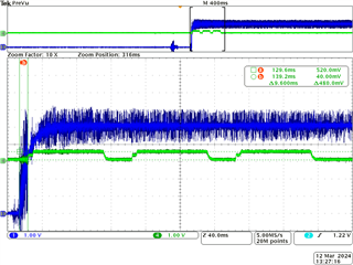

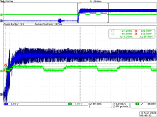

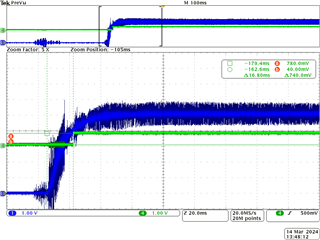

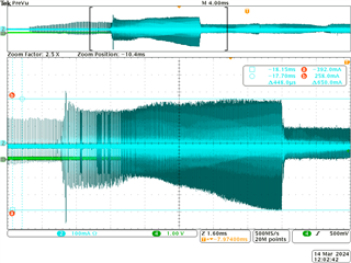

For the 0.85V output:
Blue: VSYS(5V)
Green: LDO2(0.85V)
The output voltage rises in a stair-step pattern.
The output voltage reaches around 0.5V.

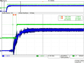

    Blue: VSYS(5V)
    Green: Buck2(3.3V)

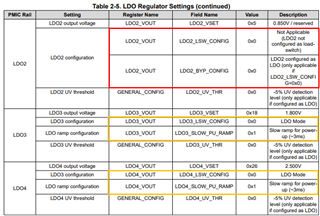

    Furthermore, from the TRM and datasheet, I found that there were violations in the capacitor requirements for the LDOs. I tried making some changes by reducing the capacitor values as follows, but it did not improve the situation:
    LDO1: 2.2uF -> no change
    LDO2: 24uF -> 14uF
    LDO3: 58uF -> 28uF
    LDO4: 34.4uF -> 24.4uF
    Is it possible that overcurrent is the cause if connecting the CPU to LDO2 results in an "NG" status? LDO2 is only connected to AM64 and not to any other devices.

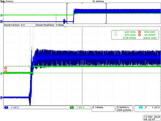

    When only the 0.85V CPU connection is disconnected, it outputs normally, but when 0.85V is connected to the CPU, it stops outputting again.
    Blue: VSYS(5V)
    Green: LDO1(3.3V)
    Blue: VSYS(5V)
    Green: LDO2(0.85V)
    In my circuit, the output of LDO1 is unused. (Buck2 supplies 3.3V to VDDA_3P3_SDIO and is connected to CAP_VDDSHV_MMC1 and VDDSHV5.)
    When R447 is removed, each power supply can maintain the ON state. However, when R447 is connected, each power supply cannot maintain the ON state.
    R447 is connected between LDO2 and AM64.

    I measured the current on the path from LDO2 to the CPU, but it doesn't appear to have any spike currents exceeding the current limit.
    Cyan: LDO2_current
    Green: LDO2(0.85V)

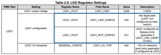

    • VSEL_SD cannot be left floating. LDO1 is configured as bypass and the output voltage is set by the VSEL_SD pin with the following polarity:
      • VSEL_SD HIGH: LDO1=3.3V (behaves as bypass and requires PVIN_LDO1=3.3V)
      • VSEL_SD LOW: LDO1=1.8V (behaves as a fixed 1.8V LDO)

    Regarding VSEL_SD,
    I have confirmed that by pulling up VSEL_SD, 3.3V is outputted to LDO1. When LDO2 is not connected to AM64, the rail remains on. However, when LDO2 is connected to AM64, the rail does not remain on.

    • LDO1 will not output 3.3V unless VSEL_SD is pulled up and PVIN_LDO1 is connected to a 3.3V input supply. In your schematic, PVIN_LDO1 seem to be connected to a 5V supply.

    >Some of the scope captures show LDO2 output only getting approximately 0.5V while other captures show LDO2 output closer to 0.85V. What did you change in the design that causes different output voltage on LDO2?
    If the power input pin of LDO2 is not connected to the power input pin of AM64, the output of LDO2 will be 0.85V. In this case, all power rails (Buck1-3, LDO1-4) will remain on.
    When the power input pin of LDO2 is connected to the power input pin of AM64, the output of LDO2 will only be 0.5V. Additionally, not all power rails will remain on.
    Implementing R447 will connect the power input pins of LDO2 and AM64. Removing R447 will disconnect the power input pins of LDO2 and AM64.
    I want to run AM64 in my circuit, but I cannot power it on when connecting LDO2, so the output of LDO2 is unusable. Therefore, for now, I am considering supplying 0.85V to VDDR_CORE from another regulator IC.
