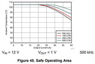

Could you please share data that can check the operating current according to the junction temperature or ambient temperature for the TPSM8D6C24, as in the example below?
Thank you.

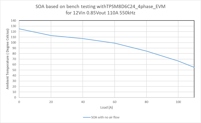

Hi Savith,
The customer's Max current is 110A and there are no specific air flow conditions, but please check with no wind and several other LFM(Linear Feet per Minute ) conditions as shown in the example.
JH

Hi JH
can you also let me know the switching frequency for this application
Thank you
Savith
Hi JH
Below data is estimate from on bench testing with TPSM8D6C24 4ph EVM with no air flow
Thank you
Savith
Hi JH,
TPSM8D6C24 is SOA limited by inductor as the inductor temp rating is lower compared to IC
Here is the temp data from PMbus telemetry and thermal camera
This data collected is on 4ph EVM bench testing
