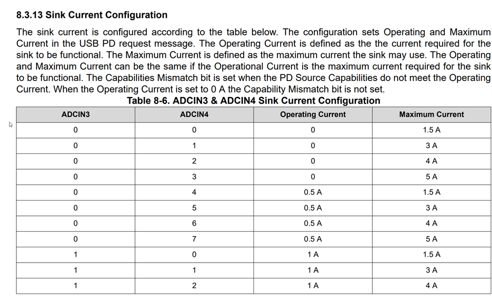

HI team,
If the PD is power sinking, how could we do to load the code without EEPROM?
Or we can't without the EEPROM to do the design?
TPS25730 is not suitable for the customer because they need 15V/4A PDO.
