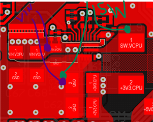

Below are the two layers of this prototype.

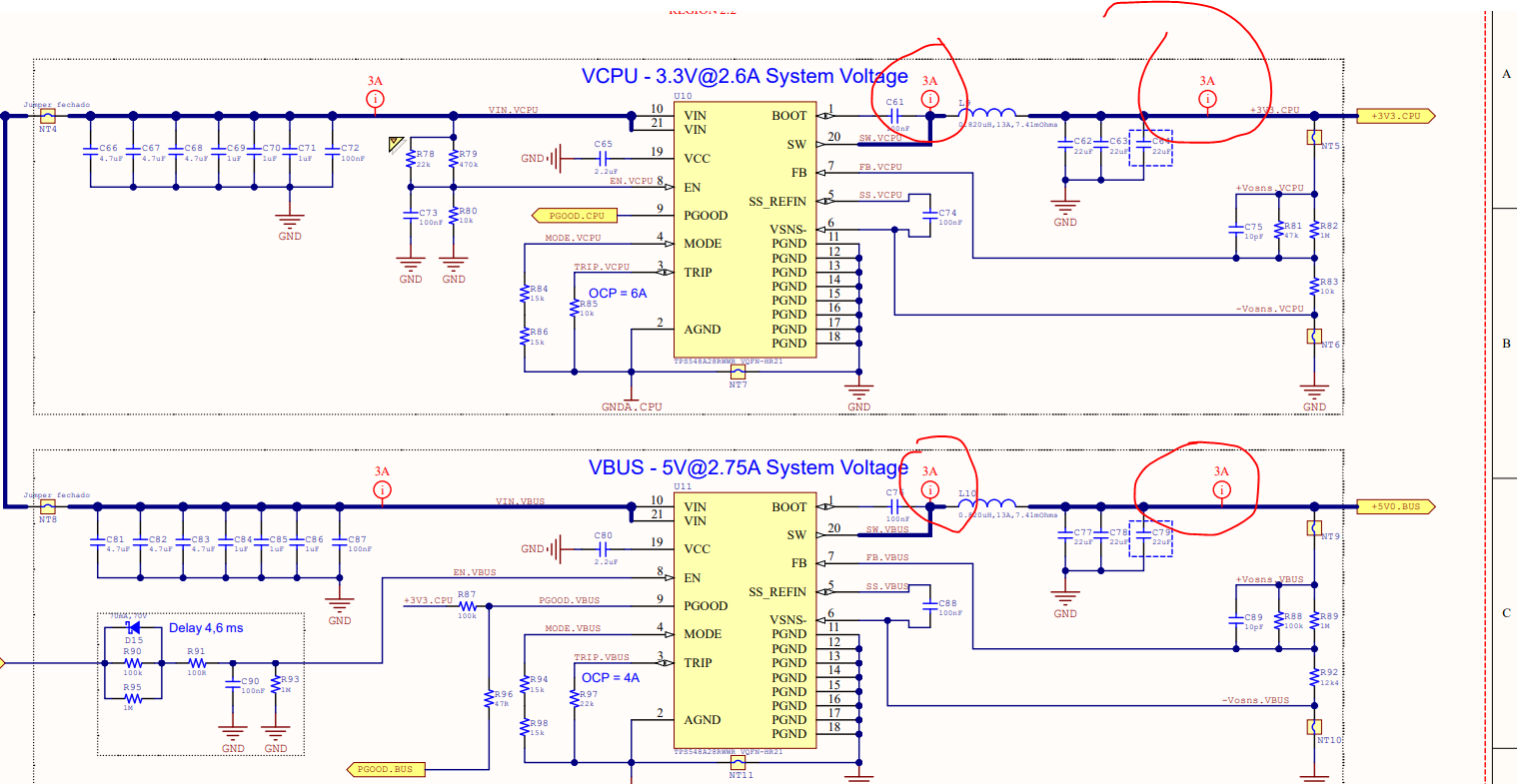

    Do you have a schematic and layout?
    Can you please attach and send them again?
    Ryan

    What is the 3A symbol mean on the schematic?
    Ryan

     The 3A symbol is just a technical note for PCB design.

    The datasheet recommends using at least 1 uF capacitor on pin 21 (VIN). It looks like you have a 0.1 uF to VIN on your schematic. Can you try removing it?
    Ryan

    My measurements were taken at these points with ground spring.
