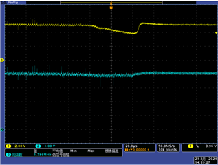

When the load device is Enable, the VREG drops and the VOUT (1.2V) stops. After about 6us, the VOUT/VREG rises and stops again.
This appears to be a VOUT (1.2V) stop because the VREG pin is below the threshold of 3.95V. However, the VDD pins (4.5V to 25V) and EN pins (0.6V) do not fall below the threshold for a moment.
Do you know the cause of this?
In the following waveform, Ch1 is VOUT and Ch2 is VREG.
A schematic is attached.

    I don't see anything in the schematic which would likely cause VREG to drop out, though VREG does have an internal current limit which would drop-out if there is excessive loading.
    The fall of VREG at 1.2V in 80μs on 1.0μF bypass capacitance is consist with 15mA of excess loading.
    If you zoom in on the switching node during those last 80μs while VREG is falling, what is the switching frequency?
    It may be possible that something attached to the 1.2V output is turning on and drawing current as it crosses 0.6V, and the converter is significantly increasing switching frequency to continue ramping VOUT, and the gate drive current at the higher switching frequency is exceeding the current limit of the VREG LDO.

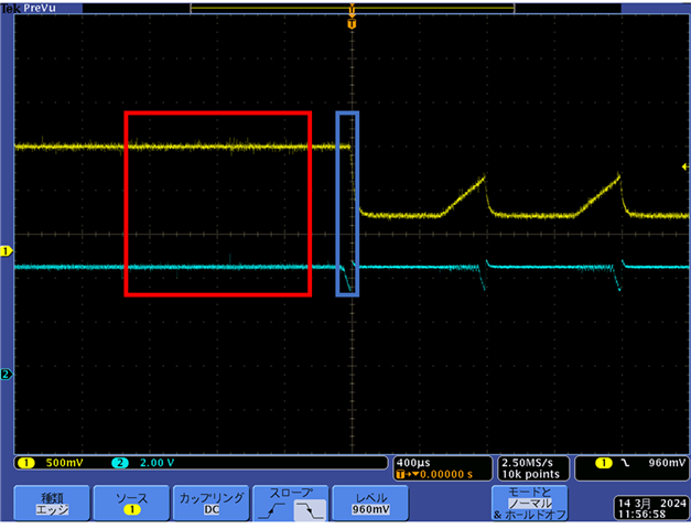

    Can you provide an oscilloscope image of the VDD pin voltage, measured right at the pin, during this same time?

    1)The switch node voltage and VDD terminal voltage in the red frame were measured. Is the measurement point correct? Do you mean the measurement in the blue frame?
    The switching frequency is 500 kHz.

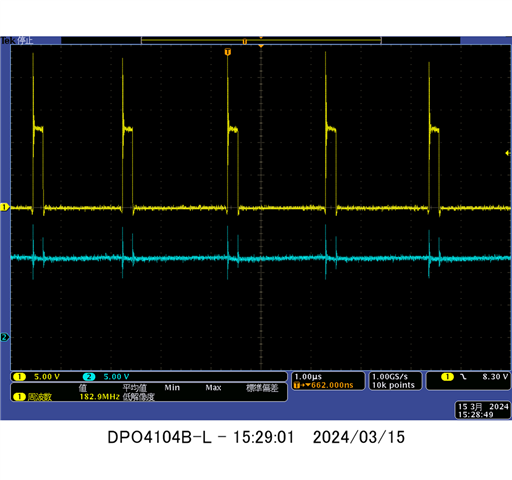

    Ch1 is VOUT、Ch2 is VREG
    Ch1 is VSW、Ch2 is VDD
    2)When the switching frequency is changed from 500kHz to 970kHz, the startup voltage, which was normal at 500kHz, is also dropped. Does the voltage drop increase when the switching frequency is increased?
    Sorry for my unclear instructions.  Yes, I meant during the Blue frame when VOUT is dropping.  If you can set VOUT falling at 0.8V as the trigger point and a time scale of 5μs / division, it should give us some insight into what is going on.
    In the graphic you provided of VDD and SW, we can see the loading current is increasing.  If you look closely at the last 2 cycles shown, you can see the slope of the top of the switching node is increasing, dropping more with each cycle.  In addition, the initial voltage on the switching node immediately after the ringing is decreasing.  The drop across the high-side FET is increasing, and the input voltage to the MOSFET may also be decreasing.
    Higher switching frequency will increase the loading on the VREG as turning the MOSFETs on and off more often will require more current.
    The MOSFET drivers essentially need a fixed amount of charge (Q) to turn-on each cycle.  This is called the Gate Charge of the MOSFET, and it's lost (discharged) when we turn the MOSFET off.  The more often we turn the MOSFETs on (higher switching frequency) the more charge per second, which is current, is needed.

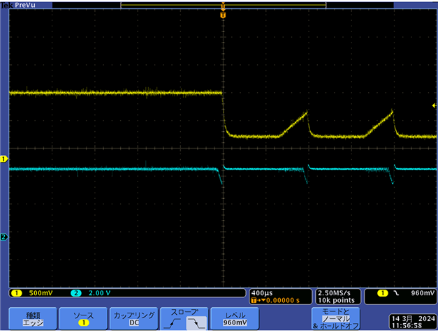

  • Hi Peter-san,
    Thank you for your comment.
    The customer measured the switch node voltage(Vsw), VDD and Vout between the blue frames. From this waveform, is it possible for you to answer the cause and solution of this problem?
    1ch: Vout, 2ch: Vsw, 3ch: VDD
    Nishie
    Unfortunately, I am still not seeing anything that would cause VREG to discharge and shut-down, and according to the schematic.  The switching frequency is not rising unexpectedly, and the schematic shows only PGOOD loading on VREG other then the internal gate drives.  While it is showing some ripple, VDD is remaining high and should keep the VREG LDO running.
    While the 3us long SW low period suggests a loading current of 15-18A with the 330nH inductor, we don't see a significant drop on VDD or SW leading up to the VOUT shut-down and VREG drop.

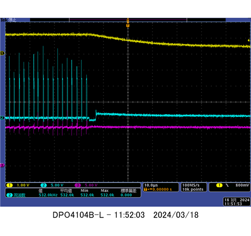

    Since PG is the only other thing loading VREG, would it be possible to get a waveform showing VREG, PG, and VBST during the last few cycles of switching before it shutsdown by triggering on VREG falling ?  I am wondering if R14 might be the wrong resistor value, and a PGOOD trigger is discharging VREG, or if R1 or R2 are the wrong value and

    I got a new waveform. Can you tell anything from this waveform?
    Fig.1 1ch: VREG, 2ch: VPGOOD, 3ch: VBST, 4ch: VSW
    Fig.2 1ch: VREG, 2ch: VPGOOD, 3ch: VBST, 4ch: VSW(enlarged view)
    The last sentence ends with “and ”, is there a continuation? Is it correct to ask the customer to measure the actual resistance values of R1, R2 and R14?
    Nishie
  • Nichie,
    The waveforms you provided do not show evidence that the issue is related to R14 and loading on VREG from PGOOD, we see VREG discharging before PGOOD asserts low.
    Your latest waveforms show a Vreg drop of about 1V on 1μF of capacitance over 30μs, an excess loading of about 33mA, which would be consistent with VREG getting turned off.
    You said that EN is not dropping below 0.6V, can you share EN and Vreg?  While a 0.6V input on EN ensures the dissable state, the actual threshold can be somewhat higher in the 1.0-1.2V range.  It is possible EN is dropping down and turning off the VREG LDO, which is then being discharged by the switching of the MOSFETs until it triggers VREG UVLO shutting down and restarting.
