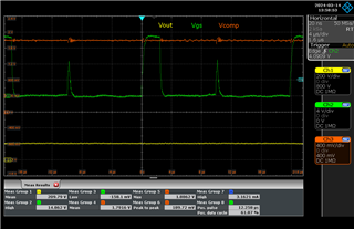

I am observing pulse narrowing in the output gate signal of UCC28C43DR IC.
For which I have probed following signals
1. Gate pulse and Sense pin voltage
2. Gate pulse and COMP pin voltage
I found no issues with COMP pin voltage and sense pin voltage which is used to terminate the output pulse.
Please let me know what can be possible cause of this narrow pulse.
    The narrow pulse is due to the CS noise based on your waveforms. The CS reaches its threshold very fast which I believe is due to the noise. You need to fix this to resolve the narrow pulses.
    Another check is to find if your converter actually in CCM operation. You need to capture the secondary side current waveform along with the primary side current. If the secondary side current not reach zero when a new switching cycle begins then it is in CCM. Then the narrow pulses may be due to from CCM operation - so one cycle in CCM and follow cycle in DCM, and repeat. If this is confirmed, one possible solution is to add the current slope compensation so to get each switching cycle the current start at the same level. Your waveforms show similar behavior of insufficient slopt compensation.
