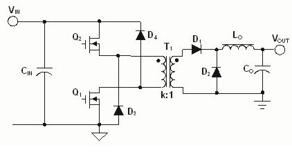

  • I assume "2SW forward" in your message meaning two-switch forward. If otherwise, please explain its meaning. If my understanding is correct, I have the below comment.
    UCC28250 is used to make PWM control in power converters such as symmetrical half-bridge and push-pull. But on a typical two-switch forward, as I know its configuration should be as shown as in the below figure, the two switches Q1 and Q2 are controlled to turn on and turn off at the same time. Then I do not feel clear how to use UCC28250 in this topology. If you have different description referring to "2SW forward" or some idea to use UCC28250 in such an operation, please describe it then we can discuss how to use UCC28250 on that basis.
    An article describing typical two-switch forward converter operation can be found through this link:
    http://www.eetimes.com/design/power-management-design/4012212/Two-switch-topology-boosts-forward-flyback-designs

  • Hung,
    Thnaks, sorry my massage not clear enough I should say "interleaving implementations for forward"I attached my concept design in attached.
    - Can UCC28250 control 2 converter(with SR) as attached?
    - if not, as you stated above what is your recomment to control these concept design?
    Thank in advance.
  • I think you can use one UCC28250 to control two forward converters with OUTA controlling one and OUTB controlling the other. But you would need external circuit to disable OUTA or OUTB at light load since UCC28250 does not have a feature to disable OUTA or OUTB individually. Also when load becomes heavier, the disabled converter will be turned on while it will be turned on right away and there will be no soft start as OUTA and OUTB were not disabled.
    If you are willing to add external circuit to achieve the features needed, it would be ok to use UCC28250.
    Otherwise, let me know and I will provide other suggestions.
