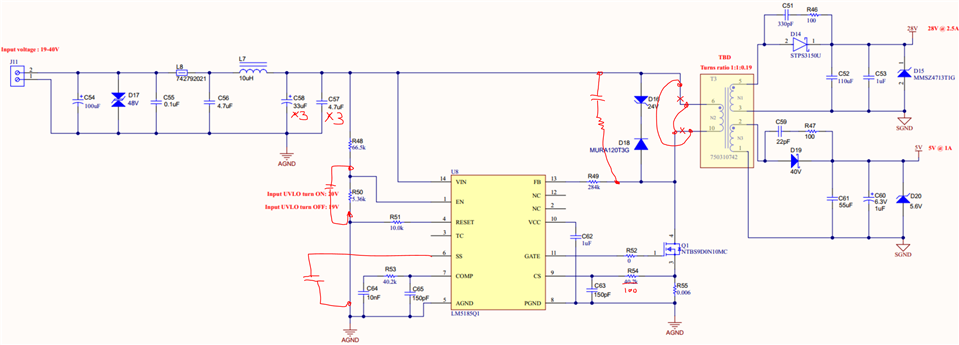

    Thank you for the clarification. Please review the below screenshot attached schematic diagram as per the design calculation inputs. (Transformer part yet to decide as per your suggestions, at present just representation I captured).
    LM5185Q1- PSR Flyback design
    Another my concerns is efficiency of the above design, I am looking for the design efficiency >90% at nominal input voltage 28VDC or 34VDC and also the stability. What is the maximum efficiency we can achieve by the above design and what is the switching frequency used for transformer selection. Please provide your suggestions if any improvisation further needed on this circuit.

  • Please see my review markup. A error is the transformer polarity.  Swap the pins.  Also, please reserve those component positions on your PCB in case you need them after test.  By doing this you can avoid having to do a PCB revision.
    Since the majority power is in the 28Vout, I think you should be able to get 90% efficiency.   See the calculator in which the switching frequencies are plotted.
    Youhao
