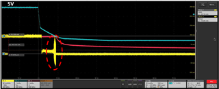

There appears to be current backflow from the SW pin to the VIN pin during shutdown.
The moment the VIN voltage drops and becomes the same voltage as VOUT, a reverse current of just under 100mA occurs.
Since the EN pin is above 1V, the PMOS remains active, so I suspect that current is flowing from SW to VIN.
(Or is it reverse current through a parasitic diode?
Does it have a backflow prevention function?)
Does this reverse current have any negative effect on the device?
