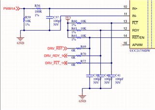

I am using UC21750 gate driver for a vienna rectifier application. I tied DESAT pin to COM, but still FLT pin is low.
Note: There are 6 gate driver on the board, two of them work as expected. Therefore;
1- I replaced the gate drivers with new ones
2- I removed the buffer to which the relevant FLT pins were connected.
3- I observed DESAT pin, it is always low (Connected to COM)
4- At the beginning of the program, all drivers' FLT pins are in HIGH state. FLT pins go low after switching starts.
Edit : 10kohm pullups connected to FLT RDY and RST pins.
My question is that what are the conditions could trigger FLT pin other than DESAT? Or could DESAT pin trigger FLT somehow even it is LOW.

    The FLT pin is designed to go LOW when the voltage on the DESAT pin has exceeded the DESAT threshold voltage for longer than the DESAT de-glitch filter time.
    The DESAT pin shorted to COM disables the gate driver DEAST function (DESAT voltage would never exceed threshold) and FLT pin should not be held low. I have some questions to get a better understating of the issue:
    • When you run this test are you running the system with high voltage applied on the rectifier or is the program only switching the power MOSFETs ON and OFF?
      • If the issue appear with high voltage applied could you try running the test with no high voltage applied?(only switching MOSFETs ON and OFF)
        • Does the FLT pin still trigger LOW with no high voltage applied?
    • If the issue appears with high voltage applied, could you provide more details of the test conditions when the FLT pin triggers?(i.e. what is the bus voltage, what is the current level going through the switches)

    I do not apply high voltage to the rectifier (about 30V L-N), but still FLT pin is low. When I disabled the gate drivers FLT pin is HIGH.

    I replaced R65 with 5K1 pull-up resistor. At first problem seemed to be solved, but still the FLT pin goes LOW as the current level increases. Why might this be happening even though DESAT connected to COM?
