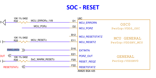

I have a board featuring an AM6225 and a TPS65219 and whose design is based on the AM62LP SK. I'm getting error messages like below right after booting my yocto custom built Linux distribution built on SDK 09.00.00.009 :
[   15.513608] irq 27: nobody cared (try booting with the "irqpoll" option)
[   15.520339] CPU: 0 PID: 114 Comm: irq/27-tps65219 Tainted: G           O       6.1.46-gf8110d9ce8 #1
[   15.529459] Hardware name: Secheron sep-disp (DT)
[   15.534152] Call trace:
[   15.536592]  dump_backtrace.part.0+0xdc/0xf0
[   15.540878]  show_stack+0x18/0x30
[   15.544190]  dump_stack_lvl+0x68/0x84
[   15.547854]  dump_stack+0x18/0x34
[   15.551165]  __report_bad_irq+0x4c/0xdc
[   15.554998]  note_interrupt+0x33c/0x3a0
[   15.558833]  handle_irq_event+0x9c/0xbc
[   15.562663]  handle_fasteoi_irq+0xa4/0x1f4
[   15.566753]  generic_handle_domain_irq+0x2c/0x44
[   15.571362]  gic_handle_irq+0x50/0x124
[   15.575108]  call_on_irq_stack+0x24/0x4c
[   15.579023]  do_interrupt_handler+0x80/0x84
[   15.583199]  el1_interrupt+0x34/0x70
[   15.586767]  el1h_64_irq_handler+0x18/0x2c
[   15.590854]  el1h_64_irq+0x64/0x68
[   15.594248]  _raw_spin_unlock_irq+0x18/0x50
[   15.598428]  irq_thread_fn+0x60/0xb0
[   15.601995]  irq_thread+0x168/0x24c
[   15.605476]  kthread+0x10c/0x110
[   15.608702]  ret_from_fork+0x10/0x20
[   15.612271] handlers:
[   15.614534] [<000000002a2a9710>] irq_default_primary_handler threaded [<000000001f5882ff>] regmap_irq_thread
[   15.624367] Disabling IRQ #27

Here's the associated DTS part:
tps65219: pmic@30 {
		compatible = "ti,tps65219";
		reg = <0x30>;
		buck1-supply = <&vcc_3v3_main>;
		buck2-supply = <&vcc_3v3_main>;
		buck3-supply = <&vcc_3v3_main>;
		ldo1-supply = <&vcc_3v3_main>;
		ldo2-supply = <&vcc_1v8>;
		ldo3-supply = <&vcc_3v3_main>;
		ldo4-supply = <&vcc_3v3_main>;
		pinctrl-names = "default";
		pinctrl-0 = <&main_gpio1_pmic_intr_pins_default>;
		interrupt-parent = <&gic500>;
		interrupts = <GIC_SPI 224 IRQ_TYPE_LEVEL_HIGH>;
		interrupt-controller;
		#interrupt-cells = <1>;
		ti,power-button;
		regulators {
			vdd_core: buck1 {
				regulator-name = "VDD_CORE";
				regulator-min-microvolt = <750000>;
				regulator-max-microvolt = <750000>;
				regulator-boot-on;
				regulator-always-on;
			vcc_1v8: buck2 {
				regulator-name = "VCC_1V8";
				regulator-min-microvolt = <1800000>;
				regulator-max-microvolt = <1800000>;
				regulator-boot-on;
			vdd_ddr4: buck3 {
				regulator-name = "VDD_DDR4";
				regulator-min-microvolt = <1100000>;
				regulator-max-microvolt = <1200000>;
				regulator-boot-on;
			vddshv_sdio: ldo1 {
				regulator-name = "VDDSHV_SDIO";
				regulator-max-microvolt = <3300000>;
				regulator-boot-on;
			vddr_core: ldo2 {
				regulator-name = "VDDR_CORE";
				regulator-min-microvolt = <850000>;
				regulator-max-microvolt = <850000>;
				regulator-boot-on;
			vdda_1v8: ldo3 {
				regulator-name = "VDDA_1V8";
				regulator-boot-on;
			vdd_2v5: ldo4 {
				regulator-name = "VDD_2V5";
				regulator-min-microvolt = <2500000>;
				regulator-max-microvolt = <2500000>;
				regulator-boot-on;
And here's the associated schematics, PMIC_INTn arrives on ball D16:
Adding "irqpoll" to Linux bootargs solve the issue but I would prefer getting to the bottom of the issue. Could it be a driver issue ? Something wrong with the DTS ? Any idea is welcome.
Pierre Buffo
    Thanks for reaching out. I will share the information with our software team and provide an update within the next two business days.

  • Here are some items to try out. I think it's the DTS file that might be missing something:
    TPS56219 DTS Documentation: github.com/.../ti,tps65219.yaml
    Example of the phandle function contents for pinctrl-0 (unsure what the contents of yours is):
    	pmic_irq_pins_default: pmic-irq-default-pins {
    		pinctrl-single,pins = <
    			AM62X_IOPAD(0x01f4, PIN_INPUT_PULLUP, 0) /* (D16) EXTINTn */
    	https://github.com/u-boot/u-boot/blob/master/arch/arm/dts/k3-am625-beagleplay.dts
    Hope the above helps!
    Shree Ramamoorthy
    Thank you for your reply.
    • system-power-controller is not needed, as my system doesn't have a power push button. I tried to add it anyway, but the issue persists.
    • bootph-all, from what I understand bootph-all only makes sense for TPL ? Haven't tried to add it yet.
    • https://patchwork.kernel.org/project/linux-arm-kernel/patch/20220805121852.21254-2-jneanne@baylibre.com/, not relevant, that example doesn't feature interruptions
    • "The interrupts defined: double check the dts definition & that it matches D16 in the datasheet", not sure what you mean by that.
    Next, regarding pinctrl-0, here's mine:
    	main_gpio1_pmic_intr_pins_default: main-gpio1-pmic-intr-pins-default {
    			AM62X_IOPAD(0x01f4, PIN_INPUT_PULLUP, 0) /* (D16) EXTINTn.GPIO1_31 */
    Previously I only had PIN_INPUT instead of PIN_INPUT_PULLUP. the PIN_INPUT_PULLUP makes sense because I don't have a physical one, but sadly it didn't help.
    Something I still don't understand is the interrupt type. Currently it is IRQ_TYPE_LEVEL_HIGH, although the interrupt is inverted (nINT). Shouldn't it be IRQ_TYPE_LEVEL_LOW ?

  • Hi Pierre,
    I will review this next week and get back to you.
  • Hi Pierre,
    Can you please provide the details of pinmux main_gpio1_pmic_intr_pins_default in your board DTS?
  • Never mind, I see you have already provided the information above in responding to Shree's request.
  • Hi Pirerre,
    The kernel boot log line 330:
    [    6.458159] input: tps65219-pwrbutton as /devices/platform/bus@f0000/20000000.i2c/i2c-0/0-0030/tps65219-pwrbutton.2.auto/input/input0
    it seems telling there is a tps65219 power button on i2c0 address 30. Can you please try to add "ti,power-button;" in the DTS tps65219 node?
