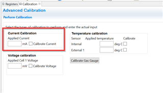

  • Hello Shivani,

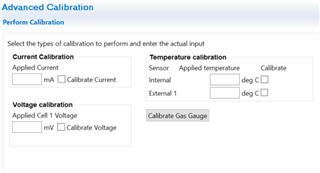

    The current calibration can be done through bqStudio. When you are doing the current calibration, you do not need the charger connected.
    Jonny.

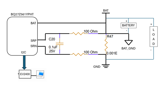

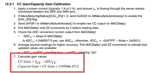

    I have begun the current calibration process by following the steps outlined in Section 12.2 of the bq27z561_trm document.
    I have done the setup as illustrated below.
    Now, I have followed the steps in the following manner.

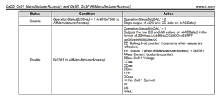

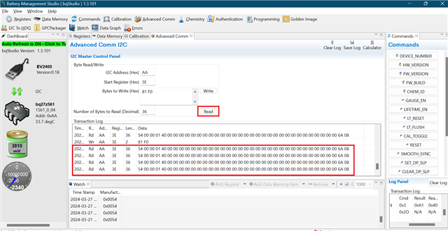

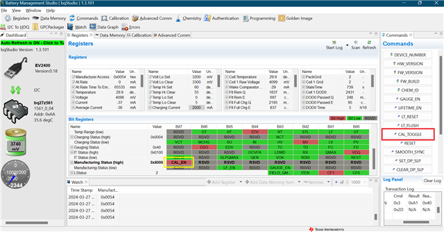

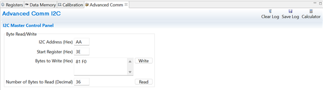

    1. As instructed in Current Calibration Step 2, I have activated the ManufacturingStatus()[CAL_EN] by utilizing the CAL_TOGGLE command in BQStudio.
    2. In order to send 0xF081 to AltManufacturerAccess(), I clicked on Advance_Comm in BQStudio and wrote the command 81F0 in the Bytes to Write field, as displayed below. Please let me know if this is the correct method for writing commands in the Manufacturer Access System (MAC).

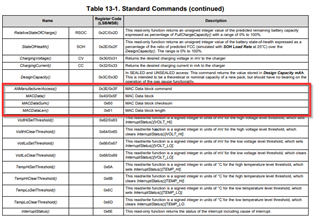

    3. Now, in the 4th step, it is instructed to continuously poll MACData() until the ZZ value increments by 2 before proceeding to read the data.
    Therefore, I attempted to read the MAC Data by clicking on the "Read" button and retrieving 36 bytes of information, as demonstrated below. However, I observed that the data remains unchanged.
    So, at this point, I have several inquiries regarding this particular matter.
    1. I would like to understand the process of polling MACData in BQStudio.
    2. In BQStudio, where can I read the format of the MACData() output, which follows the pattern: ZZYYaaAAbbBBccCCddDDeeEEffFFggGGhhHHiiIIjjJJkkKK as described in Table 11-2 of the Technical Reference Manual (TRM)?
    3. What is the typical duration for performing current calibration?
    Could you please share your insights on this?
    Additionally, is there any documentation available that offers guidance on utilizing BQStudio for the current calibration procedure?
    As the Technical Reference Manual (TRM) does not provide instructions on how to execute the steps using BQStudio.

    Please refer to this E2E thread as it goes over the I2C communication using bqStudio. I believe this will help with your first and second questions.
    For your third question, I am not sure what you mean here? For calibrating the current using bqStudio, you should be using the Calibration tab on bqStudio.
    Jonny.

    From suggested the E2E thread, it is still unclear how to observe (read/write) the MACData() in BQStudio specifically for the Current Calibration steps.
    Is there any documentation available that provides clarification on the specific steps required to perform Current Calibration in BQStudio?
    Also, do I need to utilize only the Current Calibration tab in BQStudio when performing the Current Calibration process? If so, I couldn't find any option to poll the MACData() as as outlined in Step 4 and 5 of the Current Calibration procedure.
    Shivani Patel
  • Hello Shivani,
    You can just use bqStudio to calibrate the current using the calibration tab. All you should need to do is input the current that you applied across the gauge in the "Applied Current" section of bqStudio, then click "Calibrate Gas Gauge". One thing to keep in mind here is to use a highly accurate current supplier.
    Jonny.

  • Hello Shivani,
    Please see the following table for the MACData() taken from the device TRM, and the following E2E thread as it goes over an example of polling the MACData(). You should not have to do this though if you are calibrating using bqStudio, so you can disregard this if you are using bqStudio. Something to note is that when you are using advanced comm, you should ensure that auto refresh is disabled.

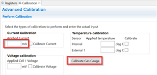

    To use bqStudio to calibrate the current, you will just need to apply a current across SRP and SRN (see the image below), then write this value in the "Current Calibration" section in the Calibration tab of bqStudio (please see the image below). This is all that needs to be done for current calibration in bqStudio.
    Jonny.
  • Hello Jonny,
    Thank you for this detailed clarification.
    To clarify, when using bqStudio for current calibration, should I apply a charge current (positive) or a discharge current (negative) across SRP and SRN?
    Shivani Patel
  • Hello Shivani,
    You can apply a positive current (charge) across SRP and SRN.
    Jonny.

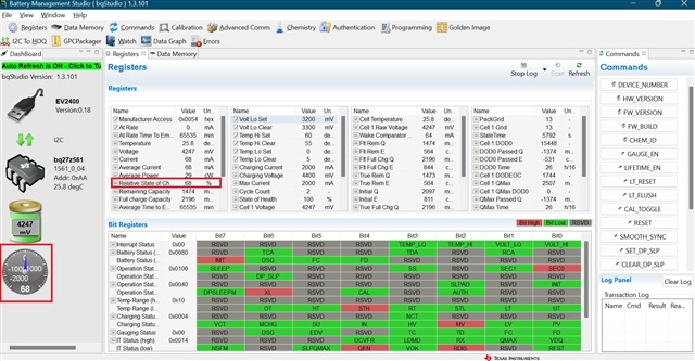

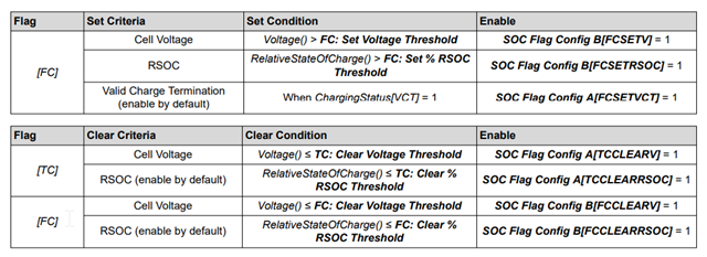

    After performing the current calibration using two gauges, the current reading (approximately 2A) is accurate according to both fuel gauges.
    However, during the charging cycle with a battery capacity of around 60% and a battery voltage of around 3.8V, the battery status is reported as Full Charged at 89%, which is an unusual result.
    Is this because of current calibration?
    I'm a novice to fuel gauge/charger. So any pointers would really help.
    Shivani Patel
  • Hello Shivani,
    Can you provide me with the most up to date gg file and the log file with this behavior? I suspect this is being caused by the parameters you have set for the gauge to detect full charge.
    Jonny.

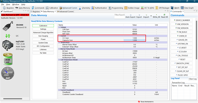

  • Hello Jonny,
    Please find the attached most up to date gg file and log file for battery status is reporting as Full Charged in between.
    Please check the below screenshot in which current reduced to 68 mA and Battery capacity showing is 68%. With this charge current battery capacity will not reach to 100%.

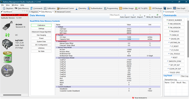

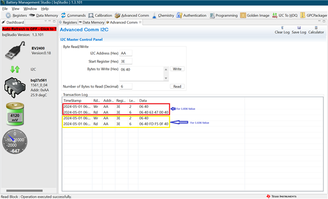

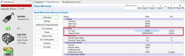

    Additionally, I have also being attempting to flash the CC GAIN and CAPACITY GAIN values obtained through Current Calibration in BQSTUDIO. Here is the procedure I followed:
    1. Obtained CC GAIN and CAPACITY GAIN value from BQSTUDIO, which is 1.836.
    2. Converted the value to hexadecimal format following the instructions in BQ27z561 TRM Section: 14.2.3 Floating Point.
    The hexadecimal value obtained is 0x3FEB020C. Is this hex value correct?
    3. Implemented the C logic provided as below to write the values through the fuel gauge driver.

    Additionally, when I did current calibration using bqstudio, the updated values of CC GAIN and CAPACITY GAIN were same (1.836)
    However, after flashing these values using the previously mentioned logic, the CAPACITY GAIN value is observed to be significantly different.
    Why the value of CAPACITY GAIN is different?

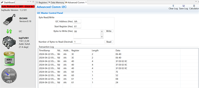

  • Hello Shivani,

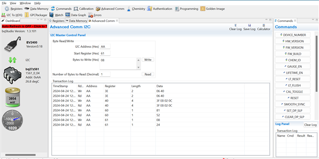

    You should be able to read out the value for the CC Gain using advanced comm that way you do not have to convert from floating point to hex. Are you flashing the CC Gain value to other gauges outside of the one you have calibrated? You will have to calibrate each gauge separately, as the calibrated values very based on the gauge.
    Jonny.
  • Hello Jonny,
    Could you please suggest, how to use advanced comm? Is there any document/reference available for it?

    1. Battery status is reporting as Full Charged in between. Requested gg file logs are attached in previous comment.
    2. After current calibration using bqstudio, the updated values of CC GAIN and CAPACITY GAIN were same (1.836)
    However, after flashing these values using the C logic, the CAPACITY GAIN value is observed to be significantly different. From datasheet, it seems like the range of the data starts from 2.98262E+02. Why the value of CAPACITY GAIN is different here?
    It would be helpful if you provide your inputs on above questions.

    This E2E thread is a helpful thread for how to use advanced comm for the I2C gauges, in this thread Nick goes over an example. It is possible that these values for CC Gain and Capacity Gain were not written correctly to the gauge.
    Additionally, The values for CC Gain and Capacity Gain should not be the same. Please see the following equations for both values.
    Using the method I described before, you would be using bqStudio to calibrate at least 20 gauges. You then would average the values for CC Gain, and average the values for capacity gain, then use these averaged values to program to the gauges.
    Jonny.
  • Hello Jonny,
    I referenced the thread you provided and followed the mentioned steps as below.
    1. Write CC_GAIN Address to the MAC Address
    W 0xAA 0x3E 0x06 0x40
    2. Write the new value for CC_GAIN to address 0x40
    W 0xAA 0x40 0x3FEB020C
    3. Calculate the checksum
    0xFF - (0x06 + 0x40 + 0x3F + 0xEB + 0x02 + 0x0C) = 0x7E
    4. Write the checksum to 0x60
    W 0xAA 0x60 0x7E
    5. Write the length to 0x61
    W 0xAA 0x61 0x08

    After following the provided instructions, I have encountered a problem where the value of CC_GAIN does not appear to be updated when I try to read it from Data Memory. However, when I read on Advanced_Communication, the value is correctly written. Please check the below Screenshots.
    Data Memory:
    Advanced_Comm:
    I am unsure of the reason behind this. Could you please clarify what could be the reason of this?
    Additionally, I would appreciate clarification on whether the CC_GAIN value should be updated exclusively in Data Memory or it needs to be checked on Advance_Comm only.
    Shivani Patel
  • Hello Shivani,
    The CC_GAIN value can be updated either using the Data Memory tab or using advanced comm. With that being said, I believe I have found the issue here with your process. The Calculation for the checksum is incorrect, the checksum should be 0x81 not 0x7E. Additionally, to see the value updated in the Data Memory, please click the "Read All" button in bqStudio.
    Jonny.
  • Hello Jonny,
    I have corrected checksum value and did the same procedure again as shown below. Then tried to read value in Data Memory section by clicking on "Read All" button but still CC_GAIN value is not getting updated in Data memory.
    Could you please help with the above issue?

    • Battery status is reporting as Full Charged in between. Requested gg file logs are attached in previous comment. reattaching the logs for this issue.
    Shivani Patel

  • Hello Shivani,
    Are you able to change the value in the Data Memory window?
    For your previous question, the FC bit in Battery Status is just a flag that indicates full charge. Please see the conditions below that determine when the FC bit gets set (screenshot is from the TRM).
    Jonny.
  • Hello Jonny,
    Yes, I am able to change the CC_GAIN and CAPACITY_GAIN values from Data Memory window.

  • Hello Shivani,
    You do not necessarily need to use Advanced Comm to program the CC Gain to the gauge. What you can do is calibrate at least 20 gauges, then take the average for the CC Gain and Capacity gain, then program this onto a gauge using the Data Memory tab (as previously mentioned). Then, you can use this to create your golden image in the future. The golden image will contain the CC Gain and Capacity Gain values.
    Jonny.
  • Hello Jonny,
    Yes, that's correct. The Data Memory tab allows us to program the CC_GAIN and CAPACITY_GAIN values.
    However, since we already have a golden image in place and the reason to utilize Advanced Comm is that when we try to program these values using the below provided C Program logic (as previously mentioned in my comment) in our driver, there is a difference in the readings obtained from bqstudio. Specifically, bqstudio reads the CC GAIN value as 2.004, and the CAPACITY GAIN value as 2668942.863, whereas the actual value we intend to program is HEX Value 3FEB020C, which is equivalent to 1.836 in float.
    Therefore, you suggested to check the adv comm option of bqstudio and see if it is working. So, based on these results and your suggestion, we need to figure out to ensure the correct programming of these values by using the Advanced Comm feature.

  • Hello Shivani,
    Even if you have a golden image already, you can upload this golden image to a gauge using bqStudio, then manually change the CC_GAIN and CAPACITY_GAIN value in the Data Memory tab, then you can recreate a new golden image with the new CC_GAIN and CAPACITY_GAIN values reflected in the new golden image, along with all of your previously configured parameters.
    Likely if you are reading the hex values for the CC_GAIN and CAPACITY_GAIN and then trying to convert the hex value to floating point, it is possible that you are making a mistake here in this conversion. This is why I recommend just creating a new golden image with the new CC_GAIN and CAPACITY_GAIN values changed using the Data Memory tab.
    Jonny.
  • Hello Jonny,
    Queries:
    1. Could you please guide me on the process of uploading a golden image in bqstudio? It would be highly appreciated if you could provide a step-by-step procedure. Additionally, since four golden image files have been generated (bq.fs, gm.fs, df.fs, and srec.fs), kindly advise which file or files need to be uploaded.
    2. What is the process for creating a new golden image? Is it necessary to repeat the entire learning cycle, or are there specific steps to follow e.g. following only charging cycle?
    In order to validate the accuracy of our HEX value, we attempted to read the value in Advanced Comm, which is written through the Data Memory tab. However, we discovered that the value obtained was different. To address this issue, I took the following steps:
    1st Attempt
    1. Write 1.836 value in Data Memory
    2. Upon reading the value in Advanced Comm, we observed a reading of 1.836 to 0x40004763 which is equivalent to 2.004.
    2nd Attempt
    1. Write 1.636 value in Data Memory
    2. Observed a reading of 1.636 to 0x400FF5FD which is equivalent to 2.249.
    Why do the values differ in both cases?
    The similar kind of behavior happening with the C logic (as mentioned previously) we are using to write the CC_GAIN and CAPACITY_GAIN values. When attempting to write the 0x3FEB020C, which is equivalent to 1.836 in float, and then reading the CC GAIN value in bqstudio, it is observed that the value is read as 2.004 in data memory.
    Could you please provide your inputs on this?
    Additionally, would it be feasible to schedule a call at a mutually convenient time to discuss our problem further and expedite process?
    Please note that we are located in the IST time zone.
    Kindly let us know.
    Shivani Patel
  • Hello Shivani,
    To upload a golden image using bqStudio, all you need to do is navigate to the "Programming" tab, then select the file location of the golden image you have previously created, then select "Program".
    To create a new golden image using bqStudio, you just need to locate the "Golden Image" tab, then create the new golden image. You should not have to redo the learning cycle as long as you first upload the old golden image to the gauge. Then change the CC_GAIN and CAPACITY_GAIN value, then create a new golden image.
    How are you converting the hex value to a floating point value?
    If you use the method I previously described (creating a new golden image), then you do not need to do this process in advanced comm.
    Jonny.
