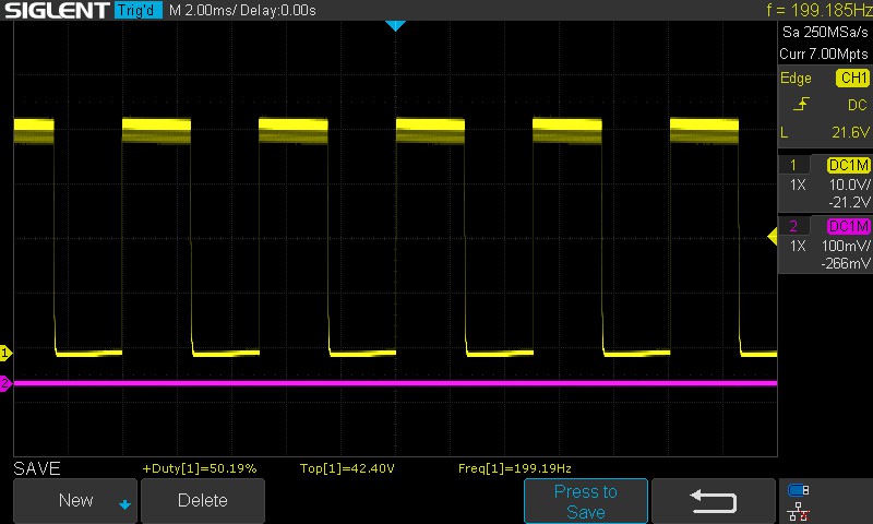

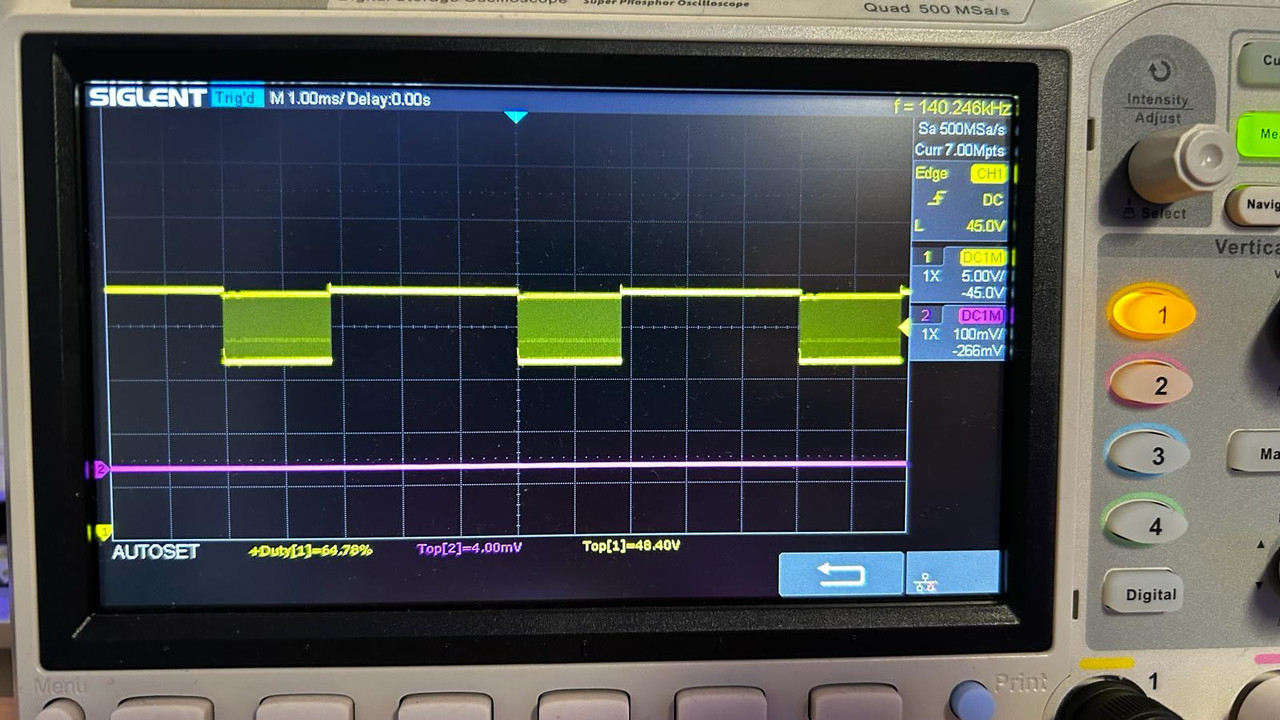

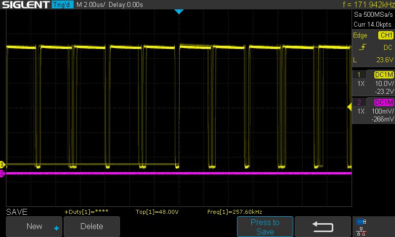

  • I send you some measure,
    Inductor:
    Mosfet gate:
    Output:
    As bad perfomance I have a very "buzzy" noise and much more heat produced. Now I'm using this cap on the output:
    CGA4J3X7S2A105M125AE TDK | Mouser Italia
    If I put an Elna 1uF 100V electrolytic cap on the output the noise is barely udible and the heat produced is much less..
    Tell me if you need more informations. Thank you!
  • Are you saying that you are getting audible noise and that is the "bad result"?  You should be looking at using a different inductor.  That is usually the source of the noise.  Are you sure the capacitor isn't cracked or something?  Try a new or different ceramic capacitor.  What do you mean more heat?  How do you know that?  What is getting hot?  Send me a video is you want.  Send me waveforms too.  I want to make sure it looks like it is operating correctly.

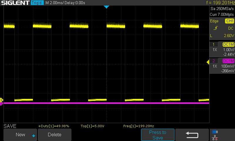

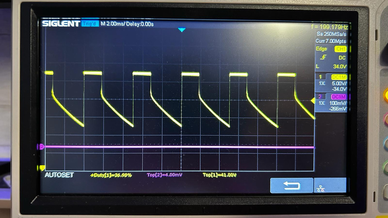

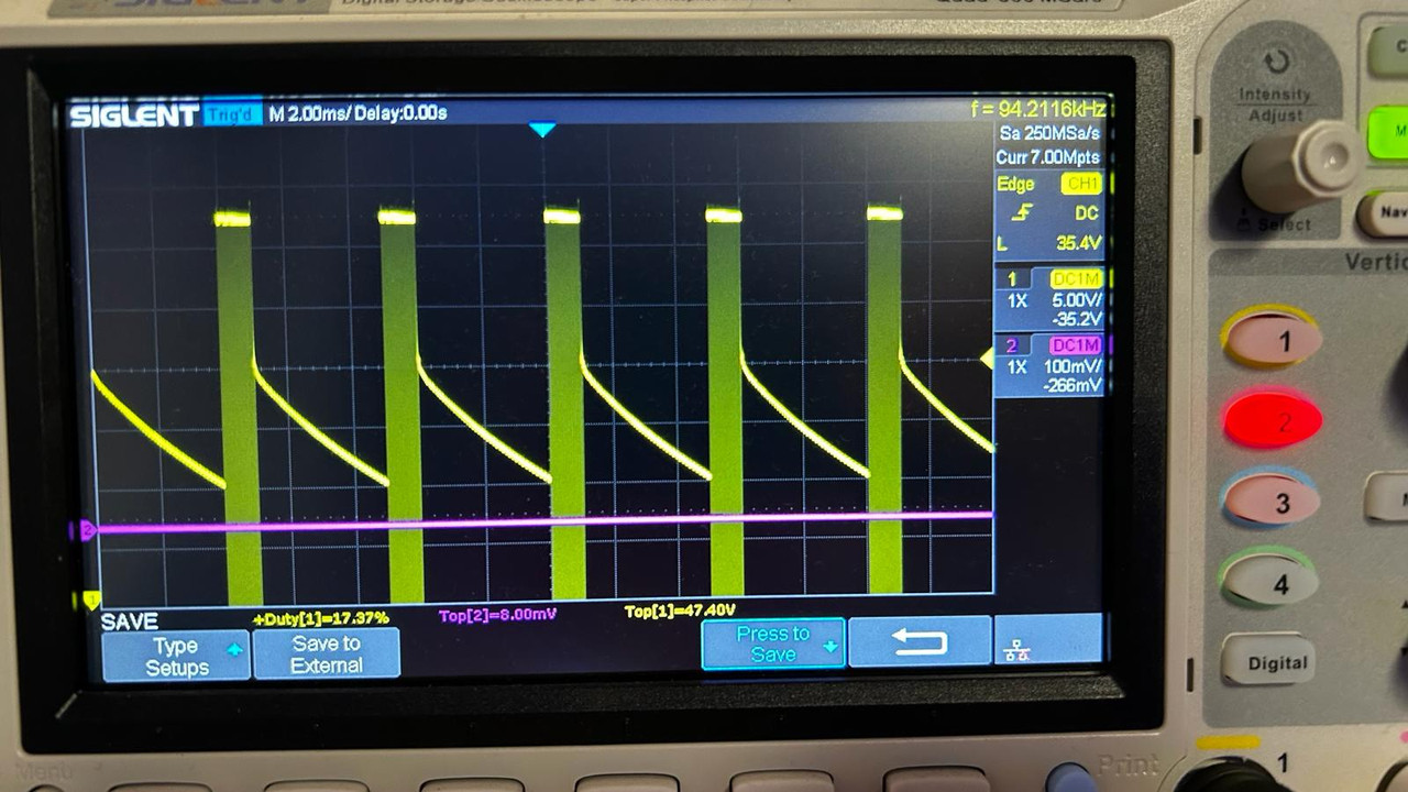

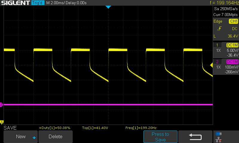

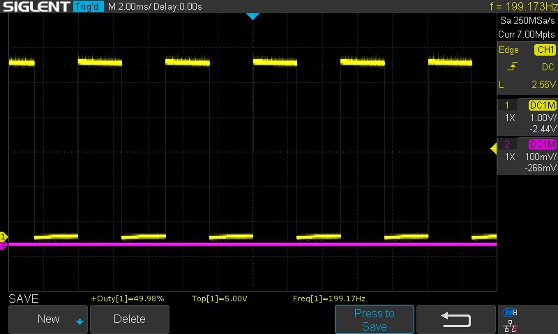

  • Thank you again! Right now I don't have a current probe, I'll try to get one as soon as possible. In the meantime I send you some of the other measures:
    WITH ELECTROLYTIC ON THE OUTPUT:
    PWM Singal on the EN pin:
    SW Node:
    Output:
    WITHOUT CAP ON THE OUTPUT:
    PWM Signal on the EN Pin:
    SW Node:
    Output:
    I have to do the temperature measure but the component that heat up the most is the diode (I'm using SS3H10-E3/57T). Inductor and Mosfet are quite warm but not too much (It's A ZXMP10AKTC - maybe I can choose a lower RDS ON mosfet)
  • The waveforms aren't showing up.  You need to use a IR Camera or thermocouple to measure the temperatures in order to see the difference in temp between the normal and electrolytic cap circuits.  Without the inductor current and the SW node it is hard to understand what is going on in a switching converter.  You will NEED a current probe.
