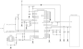

Dear TI team.
We have connected the MPU to the I2Cs of the TPS25750 for I2C communication.
To make the TPS25750 work by itself, I implemented an EEPROM containing configuration data to the I2Cm of the TPS25750.
Then, I2Cs communication between the MPU and the TPS25750 became impossible.
Is this behavior normal?
(Is it a specification that only one of I2Cs and I2Cm communication of TPS25750 can be used?)

  • Nakamura-san,
    It is not a specification that one can be used at a time. I do not know why I2Cs is not working anymore but some things to check:
    Is I2Cs SCL/SDA pulled up by LDO_3V3?
    Is LDO_3V3 at 3.3V?
    Is VIN_3V3 at 3.3V?
    Do you see I2C communication on I2Cs?
    Sweep possible TPS25750 addresses (0x20, 0x21, 0x22, 0x23)
    Chris

    My mistake seems to be confusing you and I will explain again the current situation.
    Attached is my circuit configuration.
    For I2Cs, there are no devices connected other than the MPU and the TPS25750.
    For I2Cm, there are no devices connected other than EEPROM and TPS25750.
    5V and 3.3V on the schematic are supplied from the power supply IC on the same board.
    Both VIN_3V3 and LDO_3V3 were 3.3V.
    I2Cs communication is possible or not depending on whether EEPROM is mounted or not.
    [Question 1] If the setting data in the EEPROM is incorrect, can I2Cs be used?
    [Question 2] Are there any conditions such as LDO3V3 must not be used as a pull-up power supply for I2Cm?
  • [Question 1] If the setting data in the EEPROM is incorrect, can I2Cs be used?
    No the I2Cs interface is always setup. I cannot help further on this without log captures of the I2Cs interface. You can also load your configuration into a EVM and see if results are different.
    Some but they are rarely seen. There is no reason to use other pull-up power supplies.
  • Thanks Chris,
    I found out why I2Cs cannot communicate with my configuration.
    The cause was that I was using 3.3V power supply instead of LDO3V3 as pull-up power supply for I2Cs.
    After changing the pull-up power supply of I2Cs to LDO3V3 as a trial, I2C communication of I2Cs became possible,
    The return value of I2Cs 0x03 register became "0x04 0x41 0x50 0x50 0x20".
    This can be read as 'APP' mode, so it appears that the TPS25750 is correctly loading the configuration data from the EEPROM.
