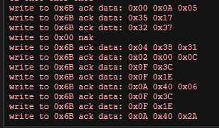

  • Hi Chris,
    This behavior has a 100% repeatability.
    Please find below the capture of the I2Cm bus between the TPS and the BQ
    - on plug event:
    reg 0x0F - data 0x1E
    reg 0x0A - data 0x40 0x06
    reg 0x0A - data 0x40 0x3C
    - on unplug event:
    reg 0x35 - data 0x17
    Additional info, if this can help: during my tests, I did comparative captures with our previous config and noticed on plug events the traces are really different. Instead of 2 writes of 2 registers separated by a few hundreds of µs, previous binary was writing 7 registers in a row (I don't join the screen captures to keep my answer light):
    reg 0x02 - data 0x00 0x06
    reg 0x00 - data 0x0A 0x05
    reg 0x32 - data 0x37
    reg 0x0A - data 0x0x40 0x3C
    Also, having the register 0x0F back to 0x41 on USB-C adapter removal is normal, reading the BQ25730 datasheet, "the input current limit is reset to the default value of 3.25 A.".
    Does it work on your side? What should I expect to see? Do I have a problem on my board ?
    Thanks and regards,
    Richard
  • Hi Richard,
    it just came to my attention that the I2C events for Sink behavior are baked into the firmware and require the 5mOhm resistor. The Source events are more configurable and can be updated in the GUI/.json, but the sink events have functionality that is not configurable through the GUI/.json.
    I don't think there is a problem with your board. I was able to test it recently, and the message I added "works", but is immediately overwritten.
    The 0x0F 0x3C write was the fix added, but it get immediately overwritten by the 0x0F 0x1E write.
    I tried a couple different writes to see if I could find a timing that overwrites the 0x0F 0x1E write, but the TPS25750 does not currently have any events that would fix this.
    At this time, the team is not planning any major updates the the TPS25750 code, and it is unlikely that they will make an update to accommodate for the changed sense resistor..
    The two options I can think of now are:
    1. stick with the required 5mOhm sense resistors
    3. Swap over to the TPS25751 (p2p, register, and feature compatible. Requires making a new JSON (very similar, but has small differences)
    Apologies for the confusion here, and thanks for your patience with the debugging.
    Thanks and Regards,
    Chris
