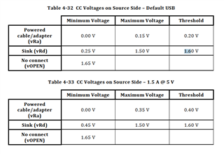

  • Hello Deepak,
    Data orientation: CC1 at 0V, CC2 at 0.45V
    Charging orientation: CC1 at 1.74V, CC2 at 0.42V
    If you need the capture of CC lines on the oscilloscope at the moment of cable connection, let me know.

  • Hello Jacob,
    As per the working of the PD controller. The PD would first need to negotiate a contract. The Voltage on the CC lines needs to be as given below:
    In the charging scenario we can observe the CC line voltage are correct. However, the voltage is not correct with respect to data orientation. And hence we cannot charge while in the data orientation.
    I will once again look through the project file settings and get back to you if any configuration is missing.
