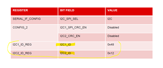

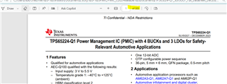

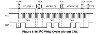

Hi team,
We are using AM62PX (PROCESSOR-SDK-AM62P) to program the PMIC of the above part number, for accessing WDG register to read / write do we need to follow I2C 12-bit register address format as this starting from 0x401. And the register address from 0x01h – 0xF1h how it is mapped to the pages? (0,1,2 &3)?
