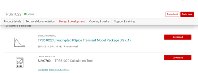

    You can use the calculation tool in ti.com to evaluate the max output current of TPS61022.

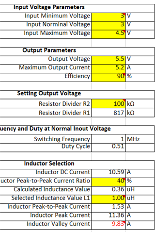

    You can find that with VIN=3V, VOUT=5.5V, IOUT=5.2A, the valley inductor current is 9.83A (assume eff = 90%), it is larger than the min valley current limit (6.5A) of TPS61022.
    So it can't support 5.5V/5.2A from 3V input. You needs to reduce the output current until the valley inductor current is smaller than the min valley current limit.

    Using the spreadsheet and the new load current, the numbers fall under the lowest valley current limit.

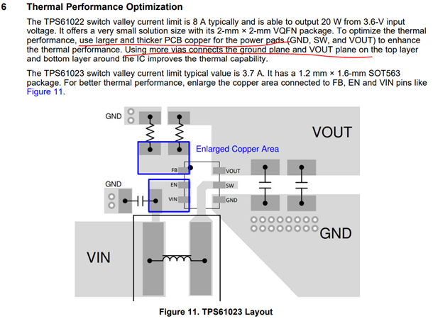

    [1] Junction Temp - For the 5.5V output with a 4A load current and 90% efficiency, I'm estimating that the device will be dissipating about 2W. The operating ambient of the product is 15C-30C.
    Do you have any special recommendations re the layout to help with heat dissipation? We are planning to follow the layout in figure 10 of the SLVAES4 (The 61022 Layout Guidelines doc).

    1.You can refer to the Section 6 of SLVAES4 about the general thermal improvement method.
