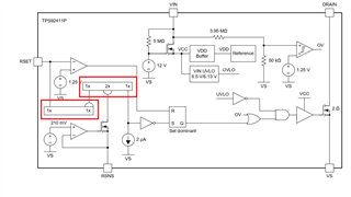

This is the block diagram of the TPS92411P. What is the meaning of the symbols highlighted in red?
Hi Punsara,
Please refer to my answer below:
The symbols highlighted in red are current mirrors. The 2x and 1x means the ratios of the mirrors. The half circle means the input of the current mirror. (For example, for the upper current mirror you highlighted, the reference current is set by the resistor connected to RSNS pin. This reference current is divided by 2 and mirrored to both left side and right side.)
