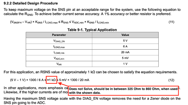

In section of 9.2.2 of the datasheet it shows how to calculate RSNS. As the answer, it gives an RSNS out of the calculated range from the example. Is this error or is 1kohm used as a rough approximation? I've attached a picture to help describe.
You are correct the 1kohm value does not solve and should be between 325ohm and 866ohm.
We will work to make this more clear in the datasheet.
