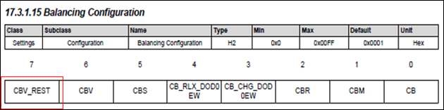

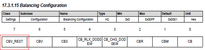

2. they found that some registers are different from bqstudio and BQ40Z50-R5 Technical reference manual. Please see the below screenshot.
↑ register setting of bqStudio
↑ register setting of BQ40Z50-R5 Technical reference manual
Which one is right? bqStudio? or Technical reference manual?

    1. Yes, that is the latest firmware for the BQ40z50-R5
    2. The register mapping in BQStudio is correct.

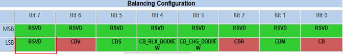

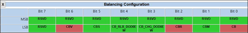

    1. Is the below bqz file latest file for BQ40Z50-R5?
    "4500_5_03-bq40z50R5_tooltips.bqz"
    2. When my customer use the bqz file above, register setting is little different between datasheet and bqStudio.
    You said that bqStudio is correct last time. Can't I use CBV_REST?

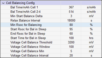

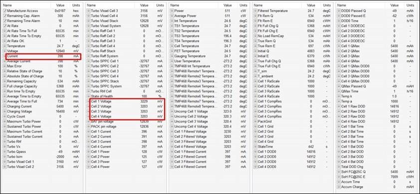

    3. My customer expect that the battery enters to cell balancing mode under the conditions below, but it does not.
    Could you check which parameter should we check to enter cell balancing mode?

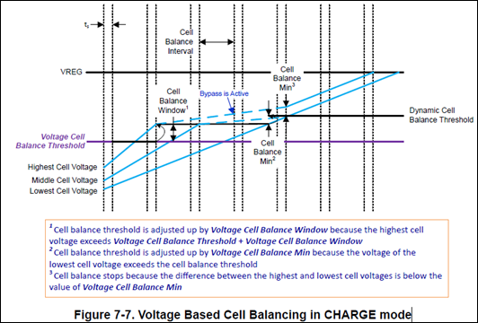

    4. Could you explain about the diagram below?
    (what is the exact condition of entering cell balancing mode?)

    1. Yes, that is the latest file for the BQ40z50-R5
    2. Yes, always follow the register mapping in bqStudio. Since that bit is now RSVD, it looks like the firmware team took out that feature in that version of the firmware.
    3. The screenshot that shows current and voltages is pretty blurry for me. It would be better if you obtained a log file and shared that so you don't have to share so many screenshots. Also, a log can show me how the registers change over time.
    4. For more explaination on this, read this app note: www.ti.com/.../slva155.pdf
    Cell-Balancing Operation section explains what conditions are needed to happen to enter cell balancing mode.

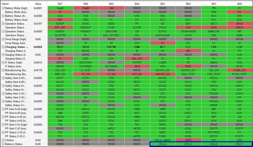

  • Dear Nick,
    Thank you for your support.
    Here are the log files and high resolution screenshots. Please check these files and advise me about not entering cell balancing mode.
    3rd.zip
    Chase

  • Hey Chase,
    Thank you so much for your patience. I was able to fully review your log file and I believe the gauge is not entering cell balancing because the learning cycle has not been completed yet. Update status (L Status) needs to be 0x0E for cell balancing to occur.
    Nick Richards
