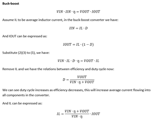

in datasheet, there is below formula to calculate Iavg. Just want to know how we get the formula, is the 0.8 the eff ? But if it's eff, why does it need in the formula ? Thanks.

Hi Given,
Thanks for reaching out.
Yes, I think 0.8 means the efficiency in the formula. As you know, the duty cycle could very with the efficiency with same Vin and Vout, so the formula take the eff into consideration. You can find more details about the derivation as below.
BRs,
Bryce
Hi Bryce,
if so, there will be eff in molecule. But in the formula, there is no eff in the formula in datasheet. Thanks.
BRs
Given
Hi Given,
Yes, from theoretically, I think there should be eff in molecule with Vin.
BRs,
Bryce
